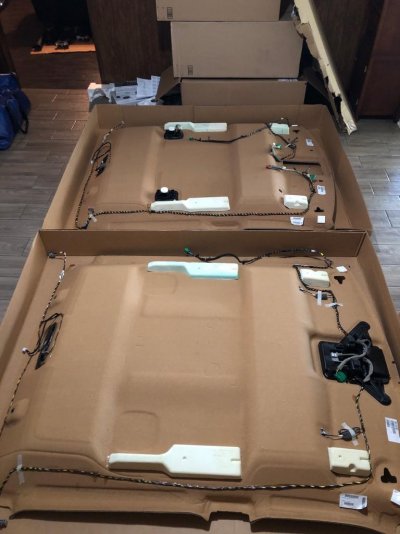

Yes you can.
Granted this was a 4th gen.
The black headliner only comes on the higher trim trucks, so I had to swap my headliner harness over to the new headliner.
An upholstery shop should be able to re-do your original headliner in a color/fabric of your choice. Unsure what that cost would be, but a new headliner is ~$900-$1200.

Awesome! I forgot about all the wiring, etc. Was it a pain? I don’t even see a 2020 tan headliner out there...
HTXRamExp
Mar 27, 2018
329
280
Houston, TX
The wiring wasn't too bad. The harness came free relatively easy using a heat gun. And I used a glue gun to re-attach it.

On my 4th gen, I took my headliner out twice through the driverside rear door.
I had both front seats, jump seat, and rear seats removed.
You also have to remove the upper a, b, and c piller trim panels (which involves the seatbelts for the b/c pillers), disconnect 4 harness connectors (rear driver/passenger side, 3rd brake light, green connector behind headlight switch), rear coat hooks, front sunvisors and sunvisor hooks, and may need to pull the rubber door trim.
It's a real tight fit, but the headliner is rather robust and bounced back without creases even with squeezing it out.
Getting it back up was way more tedious, granted I was doing it alone.
