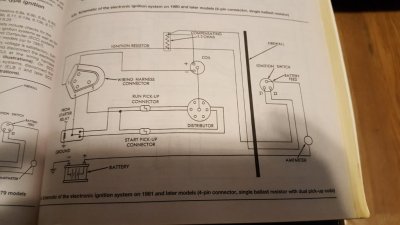

I'm assuming it's non leanburn, I pulled out the Haynes manual and found the diagram last night. (Pic attached) Fairly certain it's somthing with the start pick up system, when it quits raining I'll go out and start digging through the rats nest of wires and see if I can find anything I missed the first time.15516251822881764336311.jpg

i would be rewiring it for single pickup. i would assume since all power goes through the amp meter that that wiring diagram is for a 70's truck which would probably be another haynes mess up.
