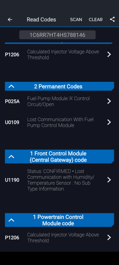

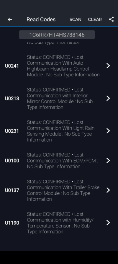

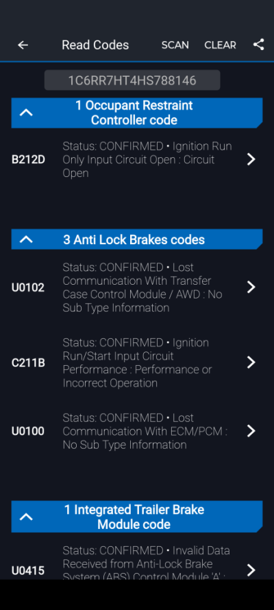

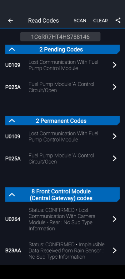

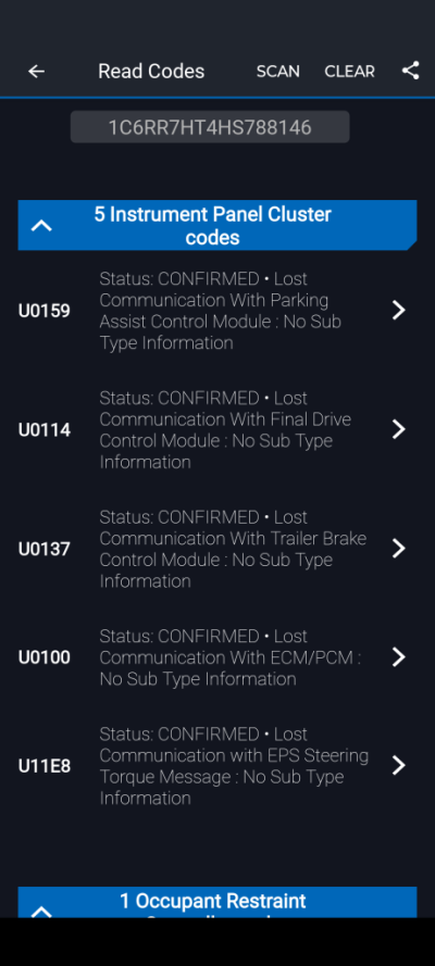

So here are the codes when I disconnected the PCM.

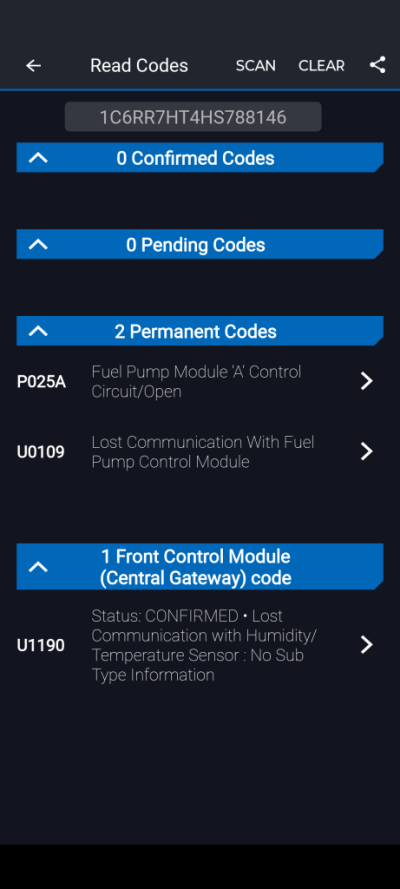

Then after clearing the codes I got this

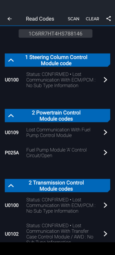

Then the next day when it started and I took more readings from the scanner I got this

So I scheduled a diagnostic mechanic to come to the house tomorrow we'll see how that goes. But in the meantime if anything comes to mind let me know thank you!
