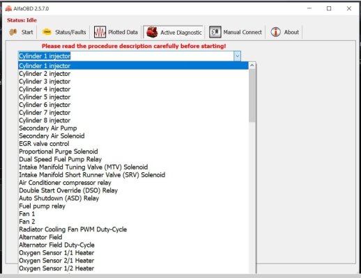

AlfaOBD will test fire the injectors individually. And with a pre 2018, no security gateway bypass harness is required.

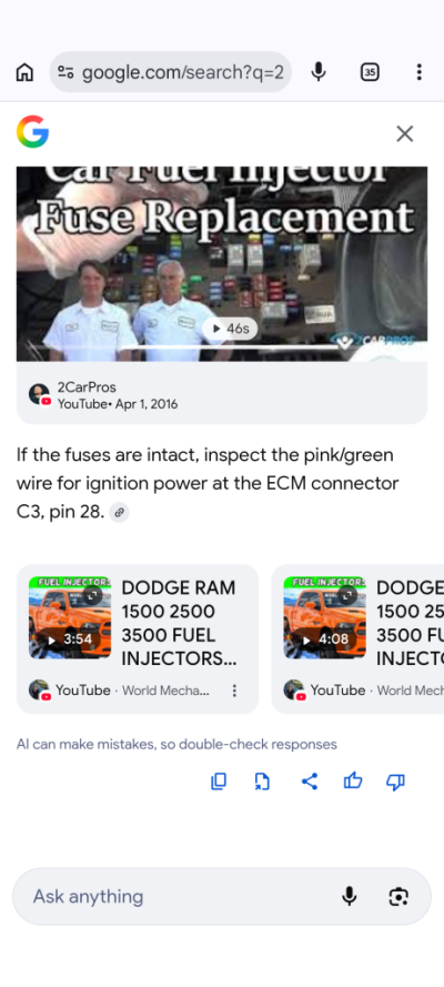

I don't think my scanner does that. Could you tell me where this pin is so I could check for power? 1000007848.png

Will Alfa actuate the FPCM ? Or maybe I should ask if that is a complete list of functions ?
That seems to be a partial list of Active Diagnostics.
If you could show the complete list ; that would be very helpful.
Thank you in advance.
