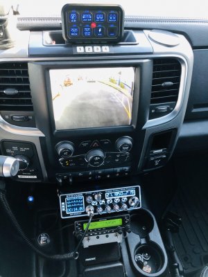

I run an AM/FM/SSB Radio and a GMRS and MURS Radio as the folks I 4x4 with, some use CB, some GMRS and some MURS so I have all and actually use CB and GMRS a lot even when not out 4 wheeling.
It certainly isn’t for everyone and is not like it was in the 70’s and early 80’s but those times got crazy on the crowded side.
Mine are mounted in a 2018 Wagon.

View attachment 241135 View attachment 241136
Exactly where I had mine. I removed it when I traded my Ram in. Yes I bought another Ram. MOPAR OR NO CAR!!
