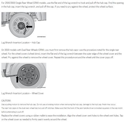

How do you remove center wheel caps 2022 ram 2500? I assume you just pry it off but don't want to break it, doesn't want to budge, Thanks

@jak0253 there are 2 slots on the center cap that oppose each other. You use the other end of the lug nut wrench to put in those slots to slowly pry each side out.

Not sure if you have SRW or DRW, or if you have aftermarket wheels.
If the cap covers the lug nuts then you just pry it off. There should be a notch to get a pry bar under it to pop it off.
If the cap does not cover the lug nuts the easiest way to get the center cap off is to remove the wheel and pop it out of the wheel from the inside.
From the owner's manual:
