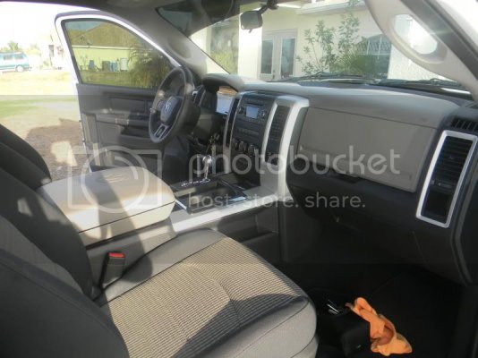

I got the shifter set up in the console and everthing pluged in ....It all works like stock like it should . I got a upper glove box in as well . I have a small issue i need to figure out before i would recommend anyone doing this swap .I want to make sure its 100 percent right before anyone eles goes and trys it . Ill post back later tonight after i fix it .
This is stock express
And now....
Only truck i have seen with a base cluster and a console ...

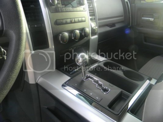

I think my problem is with the wiring harness jumper to the console shifter , I have to look into it when i have more day light to work with . It looks like a simple fix ....

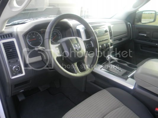

did you change out your steering wheel too?
1500ram12
Jan 23, 2012
5,487
2,432
2005
5.9L Cummins
I haven't seen any of the express models with that style with all the controls. They usually have just 4 buttons
Sent From My DROID RAZR MAXX Using Tapatalk 2
Its only on the 2012s when they moved the crusie ...2011s wont have any controls on the wheel .
1500ram12
Jan 23, 2012
5,487
2,432
2005
5.9L Cummins
I looked at a 2012 express before I bought the slt and it only had the 4 buttons. Does yours have uconnect? I think you get more control options with it
garner
Nov 15, 2010
3,979
85
Harker Heights, TX
Looks like he has the uconnect and if he ordered it with a trailer brake controller he would have the evic and all the buttons on the steering wheel
Looks good!

Any one that does the swap , post pics if you can ! I am waiting on a part to finsh my shifter to make it work right ....
Silverbullet
Apr 12, 2012
99
TEXAS
what issues are you having with your shifter? can you post part number for any electrical plugs you had to get from the dealer
W
Whitehemi
Mar 25, 2012
135
20
FL
I was missing a part so my shifter was not working right with out it .....Now everthing works like factory ...Best mod i have done to my express ...So make sure you get all these parts in order to make it work 100 percent right . You need wiring harness 68024883AC SHIFTER JUMPER WIRING to move the wiring in the column to the console ,It just makes your column wires longer to plug into the shifter in the console .
52855896AA Shifter 2009 - 2011
52109706AC LEVER MANUAL CONTROL
52104371AG BRACKET SHIFT CABLE
52855956AG GEARSHIFT CONTROL CABLE
And this is the column cover part number
STEERING COLUMN W/console shift, Gray 1GE44XDVAB
All this with a used console and console radio bezel are need to swap it in a truck with out a console .
