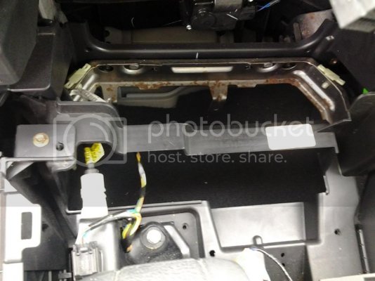

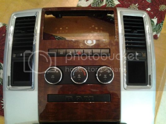

Here is a little update on this . I could not get the 115v plug on the dash hooked up so the next best thing is to cut it out .
Befor
After
And if anyone needs some pics on any of this let me know .
The rusty bracket is the front console mount . It bolts in where your lower cup holders mounted to the dash . The white round plug is where your shifter cable from the tranny mounts to the console shifter . The wire harness is where your shifter jump harness plugs in . It just extends the manual shifter controls on the column to the console .
