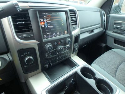

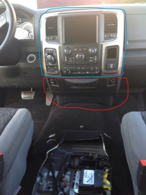

Figured I would point out the differences between the two bezels around the radio. Top pick is console out of 2500, shifter is on column but the cutout for the bezel will match cut out for a dial shifter. The bottom pick is 1500 jump seat version, the radio bezel at the bottom of the blue crcle is more curved compared to the console radio bezel, the bottom two bezels are need for the switch and of course so is the jump seat and the console itself. I believe a piece or two of duct work is necessary for the swaps too. Console 2500.jpeg jump seat.jpg
