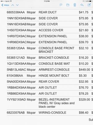

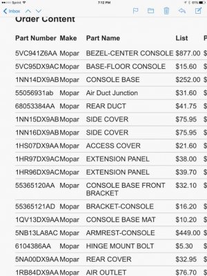

I got this list of parts from Benny for my 2015 swap. Would be curious if any of these parts are existing or already on my truck with current setup?ImageUploadedByTapatalk1455673724.270693.jpgImageUploadedByTapatalk1455673742.602145.jpg
Price we pay would be significantly lower then list ...just want to get parts nailed down first

the 75.00 side pieces are included and already installed on the console base when you order it.i've bought three new and all had the side pieces installed but the access cover isn't.for what its worth the higher priced console base i think its like 300.00 comes with the cd player installed in it but most of the time its on back order.

Ok good to know. I ordered parts so will post up a diy soon ,,,,
