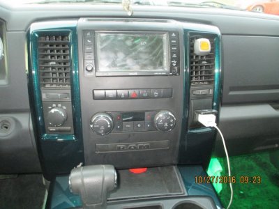

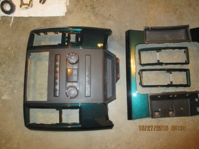

Here's what I did to mine. Painted them the same color as the truck- Hunter Green. Also did the heat vent surrounds as well. Looks cool....... Painted my shifter trim ring flat black. I'm not a fan of shiny things. Go figure.
What brand and style of paint did you use? And what was your process. It came out looking really nice, i like the finish on it. Im looking to do something similar but unsure of what paint to use and whay clear coat to use.
