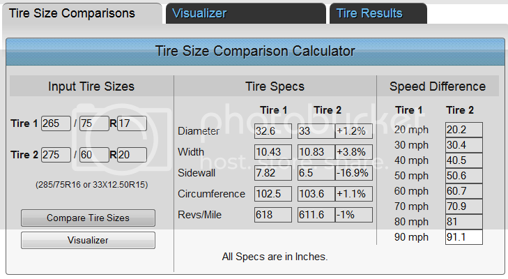

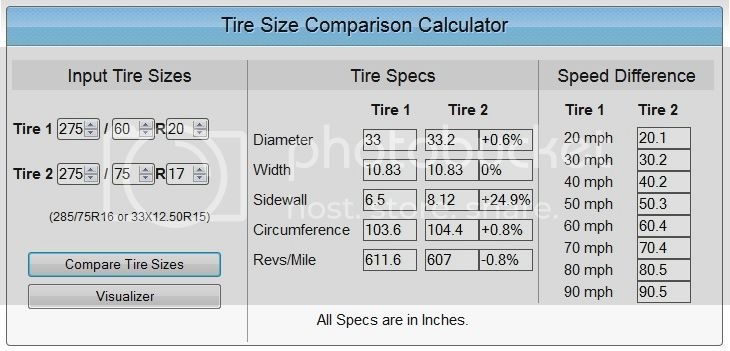

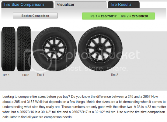

no change required at all, if tire diameter is similar
I don't know why people would think the wheel size changes anything,
unless they are driving without tires on them :crazy:
only the tire diameter can effect the speedo/odo reading
http://tire-size-conversion.com/tire-size-comparison/
There's a LOT of tires that measure approximately 33" tall
as you can see the wheel size doesn't really make a difference...
Also, most speedometers read too fast from the factory,
a slightly larger diameter tire often corrects the error.

i switched from the stock 31.5" tire to 33" tires. speedometer wasn't really off when driving alongside buddies.
But since i have a trinity, i updated the tire size anyway.

Factory tire size is a 265/70r17 is a 31.6 tire vs the 275/60r20 witch is 33 it is a difference of 4.4% at 60 you will really be doing 63... So it's not the end of the world but from my own personal experience your truck will be very touchy with overdrive. Barley touch the gas pedal on the highway it'll kick it out of OD. I recomend updatedateing the tire size it'll keep the computer happy.

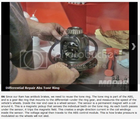

Tire pressure sensors have ZERO to do with ABS or tire speed
TPMS sensors use a 433hz radio signal to send pressure information only
There are ABS speed sensors on each front hub that are hardwired to count hub rotation speed only.
and an ABS Tone ring in the Rear Differential, neither knows or cares
what size wheels or are on your truck, it counts the electro-magnetic pulses as the carrier turns. period.
I have three sets of tires/wheels, 17's and 20's, some don't even have TPMS sensors
If what you said was true for every Ram my truck would be undriveable without a dealership flash each time I changed tires/wheels.

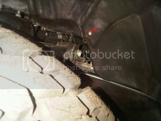

There are ABS speed sensors in the front hubs that monitors hub rotations,
but it sure as heck is not in the tire pressure sensor, and doesn't know or care what the wheel diameter is.
Here's a pic of my drivers side front wheel well,
the rubber sleeved line contains the ABS hard wired signal from the hub.
The little white push plug releases the connector so you can unplug the ABS sensor.
I've done this several times to manually disable ABS/ESP and traction control at the track for drag racing
and for dyno testing/tuning sessions with my local CMR.
17's or 20's make no difference to my ABS system at all
