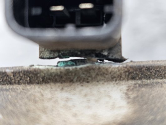

Mine was an ESIM. I replaced a few things before finding that. When I pulled the sensor and held it up to the light one of the leads was completely corroded in half. It wasn't too hard to replace. Just wanted a youtube video.

Might not even be mechanical. The ESIM installed on the gas tank turned out to be my issue. The sensor has two pins. One corroded all the way though. I replaced with a new one and drove to the store and turned the truck off. When I started the truck again, the message cleared.
