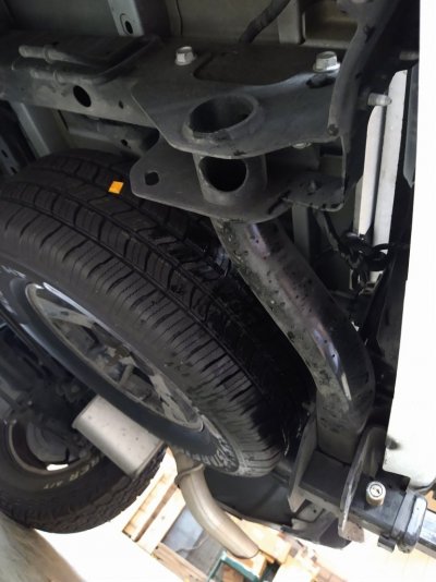

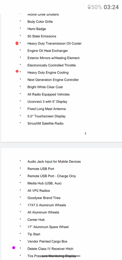

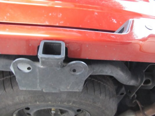

On my build sheet ... Mine also was deleted (purple dot) ... But has heavy duty transmission and engine cooler (red dots) ... Also has a factory hitch, along with both 4 & 7 pin sockets ...
Does it look like they deleted the IV & and put on a III? Or did previous owner upgrade it?
Sorry, I'm not near truck, it is in AZ, and I'm in IN at the moment ...

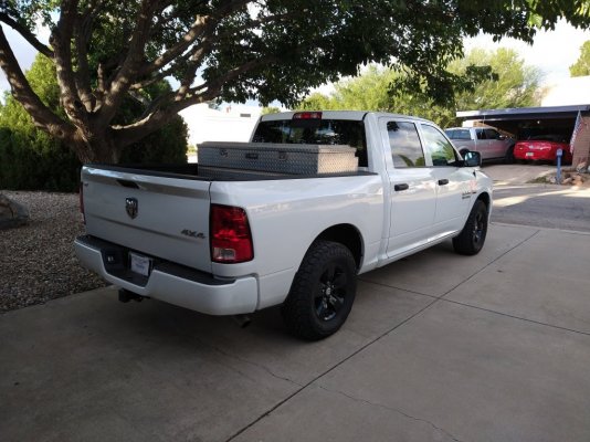

This is the best I can do for pictures at the moment ...
Looks like the previous owner added the receiver. From the pic I can't tell if it's class 3 or 4. There should be a sticker on it some where telling you the weight rating. Mine was deleted too but I just bought a Draw Tite class 4 receiver and bolted it on.

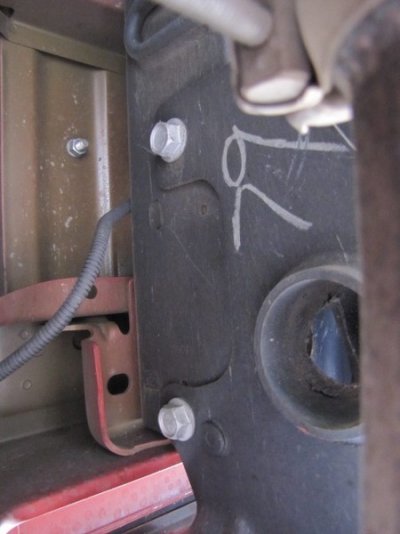

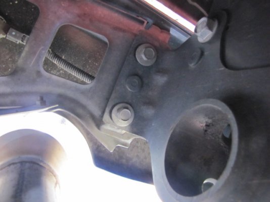

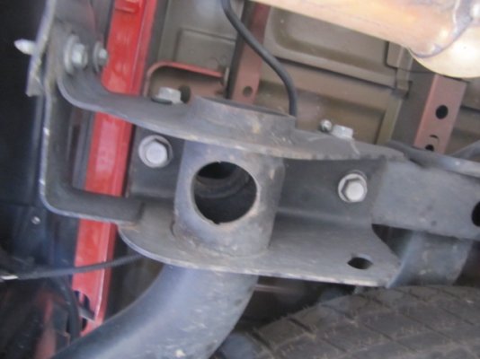

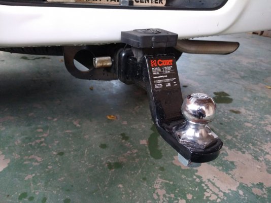

I got home last night ... It looks like what GTYankee posted pictures of ... I don't see any sticker or stamping on it has the RAM emblem on the rubber flap ...
