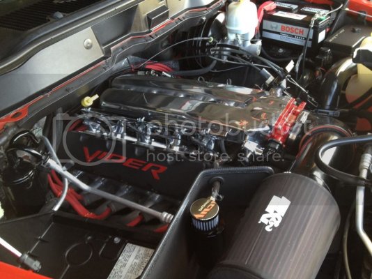

I actually spray straight simple green on my engine. Spray everything but the alternator and any major electrical wiring. Let it sit for about 10 minutes, and then lightly rinse it off. From here, take a towel and soak up any standing water...You dont have to dry off every corner of the engine, but just soak up any pools of water that are left behind. Then spray over the entire engine bay with tire foam. I usually wipe down the bigger items, but it is not necessary. Here is the finished product...

^ Very nice! I usually just throw the bucket of soapy water on the engine after I was the truck (once a week at least) and give her a good scrub down.
Matt, that looks awesome! Love the new ideas.
