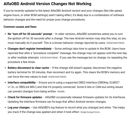

Update...I've been tooling around with the program today to see if I could get the setting on the seat belt alarm to take. The initial change did not work again, so I did some internet research with the search term of "alfaobd android version changes are not working" and the AI on the Microsoft Edge browser returned the result of:
Step‑by‑step troubleshooting:
  1. Re‑run the change procedure in AlfaOBD.
  2. Turn the ignition off for 30 seconds after the “procedure complete” message.
  3. Wait a few minutes, then check again.
  4. If no change, disconnect the negative battery for 30 minutes, reconnect, and try again.
  5. If still no change, verify your interface is working and update its firmware.
  6. Document the change in AlfaOBD’s log for future reference.
After performing step 4 I went out the truck and connected the battery. I reconnected back to the BCM, and the AlfaOBD screen on my phone said that the current setting that I had inputted prior to the battery disconnect was set to "disabled". BTW, I only disconnected the negative battery terminal. I took my truck for a test drive in the neighborhood, and the alarm never dinged. I also looked at the heated steering wheel option that I had changed yesterday, and it was set to "high/low/off". However, it did not perform the way I saw it in YouTube videos. It was just on or off when I used my finger to activate it, so not sure if it actually worked temperature wise.
When I get my lift and tire change, my plan is to perform the changes as shown in videos on YouTube. When I get home I will take look at again to see if my changes stayed in the truck computer. If they did not, I will make the changes again and go through the battery disconnect procedure to see that works like it did before. I know it seems like a lengthy way of getting things changed when the videos make it seem way easier, but I don't want tear anything up on my truck after having those major modifications done.
Here were some additional comments from the AI return on my query:
