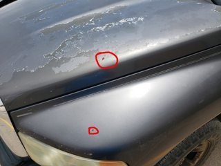

The clear coat is peeling off the hood and front fenders of my truck, and I'm looking for suggestions on how to minimize damage to the body. There are already two small rust spots which I'm going to have to sand out which can be seen in the image below.
My initial thought was to sand off the remaining clear coat and just plastidip the hood and fenders. I was going to buy the aerosol, but a customer service tech for plastidip said that the coverage wouldn't be ideal for that large of an area. I then decided I'd just plastidip the entire truck. I have a limited budget and this seemed like the most cost effective way of preventing rust, and fixing the other cosmetic issues, scratched paint, fading, etc. However, I got to thinking and I don't know if the plastidip will bond properly without the clear coat. Also, my wife hates the idea of plastidipping the truck and would prefer I just get it painted professionally.
I won't be able to afford getting it painted until after the 1st of the year (income tax), so should I just sand and primer the hood/fenders in the meantime, or would plastidip be a viable option until I can get it painted?

Sand it all down, then go to automotivetouchup.com and order some base coat (get the paint code off your door) and a few cans of the spray max 2k clear coat. It'll be under 100 bucks to get enough to do the whole hood and if you take your time and do it right with excellent prep work it'll look really good

Well you could do either or. If it were me I would sand it down to metal, then use a adhesion promoter, then primer then base then clear then wet sand and or polish. But you could also just sand the clear off or until you start to see primer and go from there. But do your best to sand it all evenly if you dont take it to metal, and make sure whatever your painting on top of is solid
