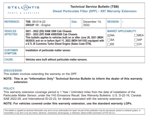

I also researched the Particulate Filter Service they said I neglected to perform. This service is to be performed around 75,000 miles.
What 75k service are you referring to?
Condensed maint. chart
