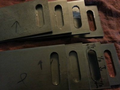

Do you have pictures of what you've done with the UCA? I've trimmed my spring I'd guess about 1-1/2 along with drop spindles. The adjustment slots have been extended. I'm in spec and it drives good. but if I do anything more the UCA mount will need to be modified.

Theres a kit sold by michighan metal works that does exactly what i did. The cost of materials and doing it myself was the easiest and cheapest way out. I used 3" flat stock 3/16 thick and had slots machined in them. I cut 8 pieces 5" long then cut pieces to brace the factory mounts and go between them as you can see in the pictures. Ive got almost double the adjustment capability over the oem mounts. Truck aligns perfect ever since i raised the mounts.

Nicely done...
