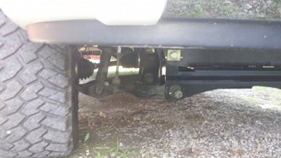

Ok so I have an 08 1500 qc 4x4 and put a 6 inch suspension lift on it about 2 months ago. I looked at the driver's side fender well today and noticed grease. When I looked at the cv axle the boot was broken. I no lifts can be hard on cv axle but that seems a little soon. Any one else have this problem or know why it happened so fast?

How many miles are on the truck? Could be a combo of the lift and the existing miles

54k is very early to have CV issues.
Do you take it out through the mud and sticks frequently, or is it more of a pavement princess? Raggin on a truck out in the woods is WAY harder on the CV Boots than mall parking lots.

It hasn't made it off the pavement yet the only other issues iv had is a little death wobble and im not sure if that would cause the cv issue or not.

It certainly wouldn't HELP the CV boot's life.
Post up a picture showing the angle of the CV shaft.

I will post a pic tomorrow the cv angle is not bad its a pro comp kit and calls for 35s. I only have 33s on it now

Here's some pics of the cv's

It may not be the case but is it possible that the boot may have been pinched or damaged when the lift was installed? Just throwing that out there. I've seen it happen a few times.

it probably just had the boot pinched during lift installation.

this happened to my dads truck 3 weeks after he had the lift, he has 4 inch bds lift on his 2012 1500. the guys that put on the lift said they may have caused it due to over tightening and such. dodge fixed it for free

i got lifted at 60000 6 inch zone. a month later i noticed the front cvs were seepin oil from the pumpkin. pissed off, but its prolly always been like that i just never noticed at stock height replaced cvs. opened it up and it was the shaft inside not the cvs. so i got new ones in now but its def an expensive i wasnt ready to pay for.
