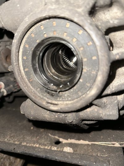

I have a very odd situation… At some point over the weekend my truck ended up in some mud (not my fault) and there was an audible snap/popping noise. The ABS light and Traction Control light came on simultaneously as well as the front driver side wheel not engaging. It could have been the front passenger side wheel as well, but I don’t know. I tore apart the front driver side, removed CV Axle and the intermediate shaft that goes into the front differential and found nothing broken, snapped or sheared. I also found nothing broken snapped or sheared inside of the front differential housing or any of the bearings. There’s no play in them whatsoever unless the Intermediate shaft and CV Axle are inside the housing. Is anyone familiar enough with a 2014 Ram 1500 4wd truck that could offer some pointers. I did about 4 hours of diagnostics on it last night and have no idea or conclusions with confidence on what it could be. The front driveshaft does look newish, but it also looks like it might be in a pinch so maybe that caused the audible snapping noise and that has now put a pinch on the shaft, but when I tried to remove the shaft it did not budge. Any pointers would be helpful.

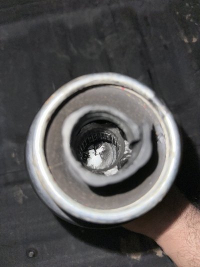

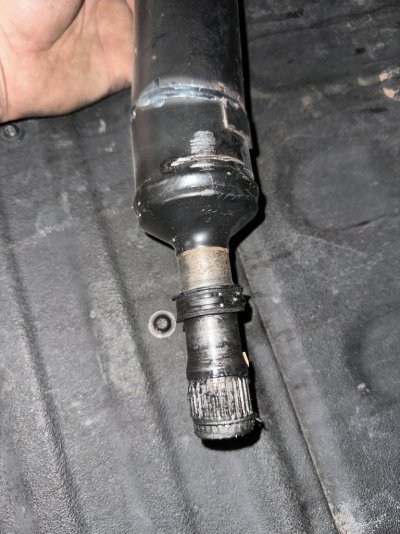

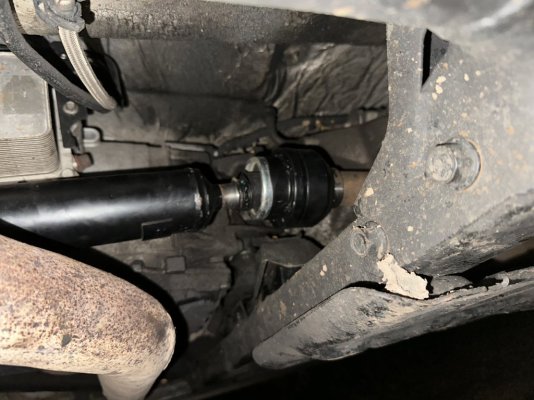

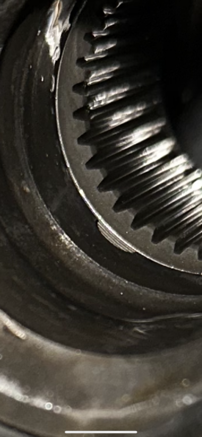

so I replaced the CV axle and wheel hub, that was not the problem. After further troubleshooting I found the front driveshaft was in a bind and it does not spin in unison. The front diff side spins and the transfer case side does not. This was after wrestling with it and driving down the road some, the driveshaft came out of the bind it was in. The driveshaft will not come off. Any other recommendations on how to get it off? I took off the 4 flange bolts and no other bolts. Prying it and smacking it with a hammer have yielded no results
Jan 17, 2016
23,817
54,819
14 Sport
Unbolt the diff itself,only 7 bolts hold it in place,the 3 on the top are the only ugly ones to get at.That's if i'm getting what you're having issues with. If you can't actually get the shaft off the splines,then you'll probably have to heat it with a torch "carefully" and quench it a couple times with a good penetrating oil not WD40,and have a fire extinguisher handy

Does the output to the front driveshaft from the transfer case rotate without a lot of effort?
