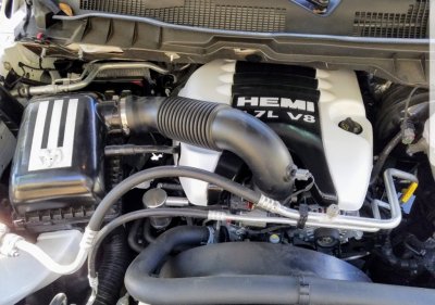

Enclosed with provisions to attach to the fendor cold air inlet. Open boxes get a lot of hot air from the engine compartment. Not good unless you want a HAI. ;)
As Graygoose stated, S&B & Volant have some good enclosed systems.

I can’t say anything bad about my S&b I had on mine. I even ordered it for my new truck coming in.

S&B like others have recommended is a great choice. However just a CAI alone with no other mods is basically a complete waste. The stock airbox is actually a very capable intake, more than people realize anyways.

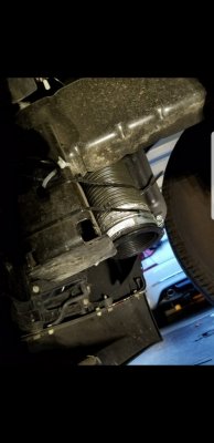

Stock box, drop in high flow filter and a add a tube 3" from box to behind front bumper helped my stock motor pull better/longer. Kind of like an added breath on upper rpm/wot!

The Mopar CAI is also an increased airflow system that will improve combustion air density by ingesting cooler intake temperatures.
Paired with a proper tune, it is ~30 wheel horsepower at the tire under the curve at elevation.

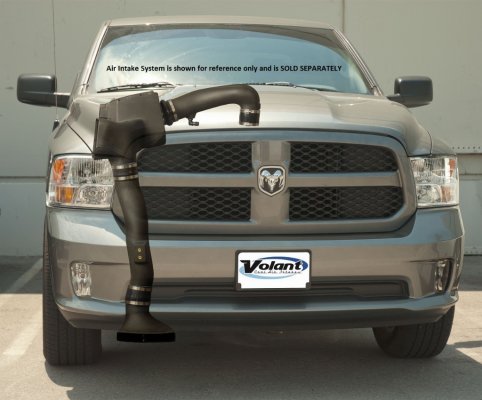

I have the Volant kit(with the Donaldson air filter) . I like how the scoop brings in air from in front of the vehicle.
I personally prefer the kits that are installed under the hood, not on the outside of the truck ;)
Definitely going to get cooler air though!
I’ve always thought that setup was pretty damn cool. However I feel like the Vararam snowy climates in not sure if the lower snorkel would be good.
