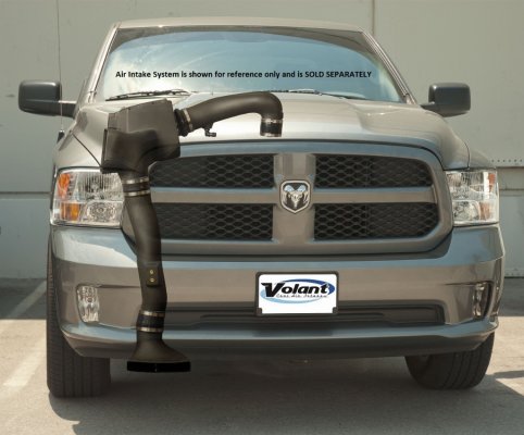

so now after 9 years they made a air induction for my volant ! did my own drain pipe fiberglass in bumper cant see it on freeway once got 21.6 mpg and now cooler wow it sooo boost the power I feel but in summer engine sooo hot air out side is cooler so runs better I feel ! now can get on ebay cheaper and a california sticker lone time awaiting ! I have it programmed 91 oct and better setting so it has the power I sooo love ! to each there own oh one thing I did block off side towards fender look in side fender a square flange bet it lets dirt right in to ur air cleaner anyone else see this ?

Stock box, drop in high flow filter and a add a tube 3" from box to behind front bumper helped my stock motor pull better/longer. Kind of like an added breath on upper rpm/wot!
Oh, and paint for another 5 hp...lol
I thought of trying that-just figured the air would be same temp as that from the wheel-well, perhaps it does help by forcing air in at cruising speeds-- I may try-its cheap enough,however weather is going to ***** now-wish I tried it in the summer!
It definately wasn't/isn't about the air TEMP more about the air FLOW. Ambient air from either place, bumper or fender, but added opening and tube means added air intake...
