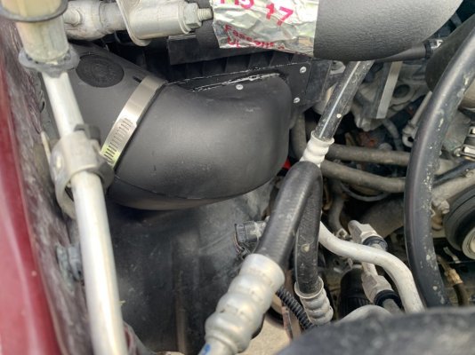

There is plenty of space for air to get to the air box. Only thing better is a track intake aimed through the grill to get forced air into the air box. The plastic guards help keep the engine bay hot air from reaching the inlet tube. You could pull the wheel well liner but then dust and mud get flung up. I have that issue because my liners are cut back a lot for my off-road bumper and I get water and debris in the air box when I go off-roading. Installing a snorkel now because of that. Snorkel goes in tonight. Was letting paint dry before install. I wouldn’t recommend a snorkel for a daily street truck though. The stock setup actually does fairly well which is why all the big CAI manufacturers use the stock inlet area for their intake. I’m just using a larger filter in my air box for increased airflow but kept the paper style so it’s cheap to swap. I used oiled filters before and switched back to stock with a 6.4 air filter and saw 0 difference in performance.
This is so sick!!! Crazy custom work!!! Send pic when snorkels installed and ready for use.

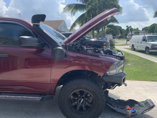

As asked here is the final product. Haven’t driven yet.
Nice work! How'd it drive?
