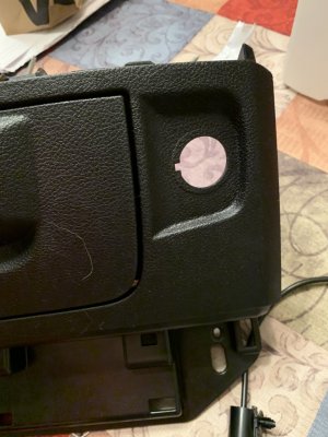

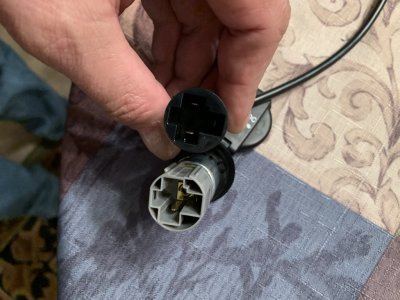

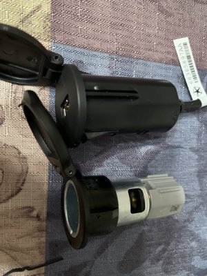

You sure can, I installed a center console and have switched all of the power outlets to usb. The oem USB ports have the same alignment pin and same connector. You can either swap the one from the right to the left or you can order a new one for the left side. They simply pop out, pop the new one in and connect the power.
I would suggest removing the bottom plastic it’s only a few bolts, way easier to pop out from the back.

Also, I tried swapping the two plugs. It’s not possible without extending wires. The right USB plug is longer and tucked up near the HVAC vent so it won’t reach. Going to run a dedicated line from the battery.
I’m sorry I misunderstood, I thought you wanted the usb to be on the drivers side, you wanted constant power to the drivers side correct?

What does it look like after installed? I have a 2019 Ram Classic with bench seat setup and wondered if this would fit.
