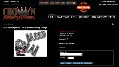

Does anyone have any first had experience with Crown Suspension front lowering springs on a RCSB 2WD truck? Their website list the same spring for all cabs except the MegaCab. If I use a 3" drop spring on a RCSB will I get an actual 3" drop or will it be less because its 3" for the heavier CrewCab trucks?
I tried reaching out to them via Email, Facebook Message and called on Monday with no answer...
https://www.crownsuspension.com/lowering/2009-up-dodge-ram-1500-3-front-lowering-springs/

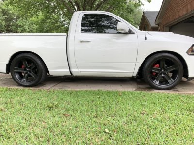

I’m running the Crown 3” front drop springs on my 2014 reg cab with the stock control arms (up front) - I ended up cutting 1/2” off the driver side and 3/4” from pass side to get both sides at this height. Previously, I had cut Belltech springs on before that brought it down a touch lower, but it was enough that my tires (245/45/22) would hit the inner wheel well liner on bumps...

Looks great. So you cut the Crown springs to level the front, left to right, not just to lower it a little more?
I was planning on running the Nitto NT420V in 304/45/R22 that specs at 32.8 inches tall versus the OE tires at 32.1 inches tall ...

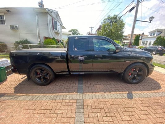

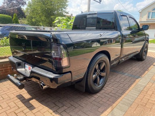

Had Belltech 2”/4” struts broke kept the springs and put back original struts no issues.
I stuffed 295/65r20 (35”)and had to change ball joints to Moog to get alignment right. Corrected rub on drivers side by rerouting harness and bend over metal seam also heat liner. Barely rubs. Bump stops need to be replaced
If I had to start over would have went with Moes/IHC and left 33” tire though I love the look of Michelin 35” M&S

I had Belltech springs in before, but ended up cutting too much, which is why I swapped to the Crown springs (just happen to still have them from a prior experiment.
No, I only needed to cut about a 1/4” on pass side to get them even. The additional 1/2” cut what to get them lower.
