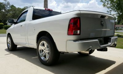

Wheels are in good shape. Tires are still on them but they're mostly used up. No TPMS.
Do you just have a stockpile of stock stuff laying around? :roflsquared: Where did those wheels come from? I thought you had srt reps and then some aftermarket ones?
Uhhhhh... Sort of? Hahahaha. I tend to collect parts for my vehicles.
I sold the reps to R/T_Fire a few months back. I was using these wheels to drive around on until I found some new wheels I liked.
Yup and I have still yet to paint them lol... Its nice having 2 sets of wheels.

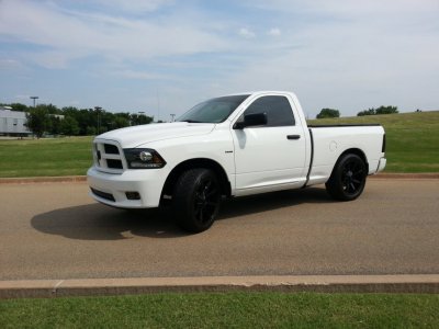

I'm still on the fence with what I'm going to. If I drop to a 20" wheel and low pro-tire combo I may go lower than a 3-5 drop, 2" from spindles and 1" crown springs... May just leave it till I tear it apart and look into coilovers.. and may go talk with a shop in utah while I'm back there in a few weeks after meeting and talking with the owner this past weekend. just depends on schedule and budget and cost by the time the shop can do the work... I'm up in the air and all over the place.
Going with a Mcgaughys front system with crown springs and qa1's will set me back about 2k.. just looking to see if that is money well spent or not
