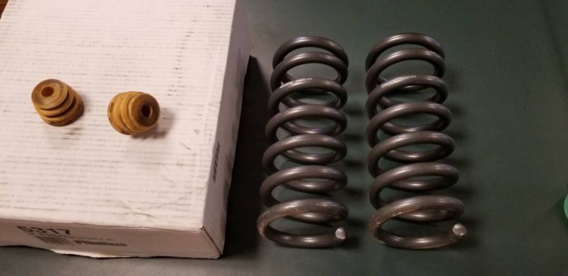

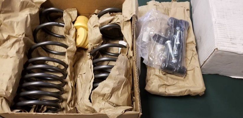

I only have the front springs and full rear kit, I bought the belltech kit without the shocks. ac0e426a0f24540e904939571984b281.jpg3b1f2115d1325858dfc4b94829afeb0d.jpg
