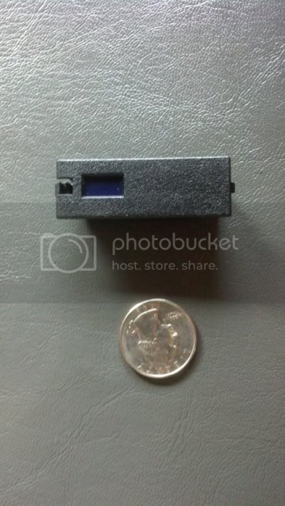

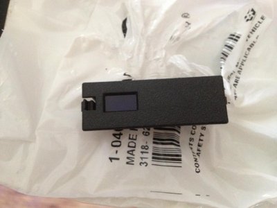

Here's what the light looks like

FlaglerMegacab4x4
FlaglerMegacab4x4
Mar 10, 2013
199
14
Florida
2006

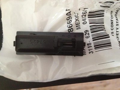

Sorry idk how to add multiple pics to one post

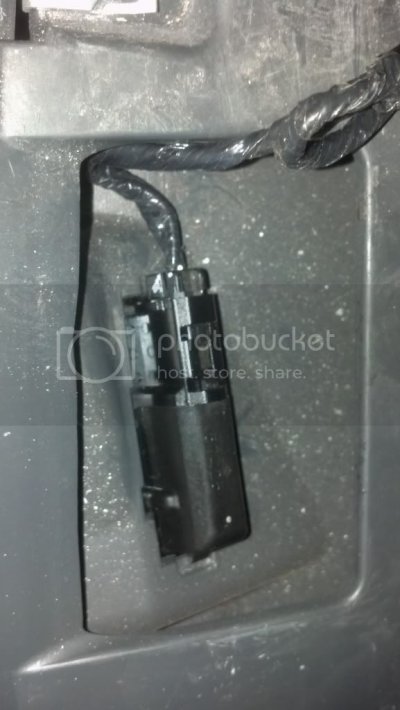

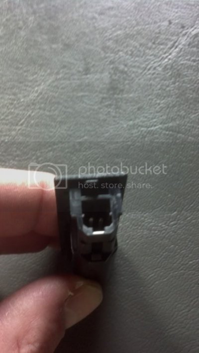

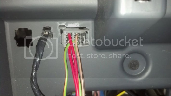

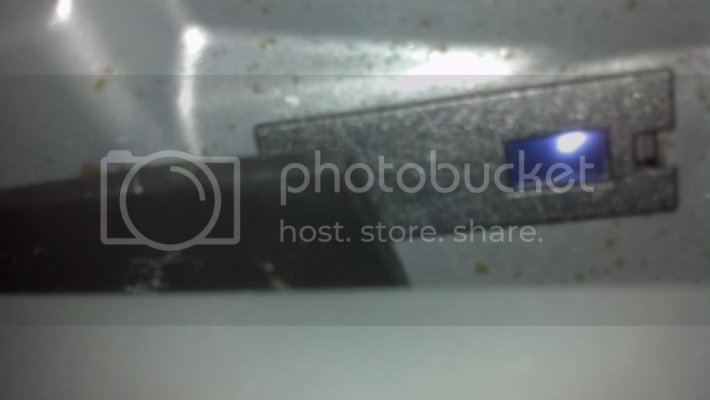

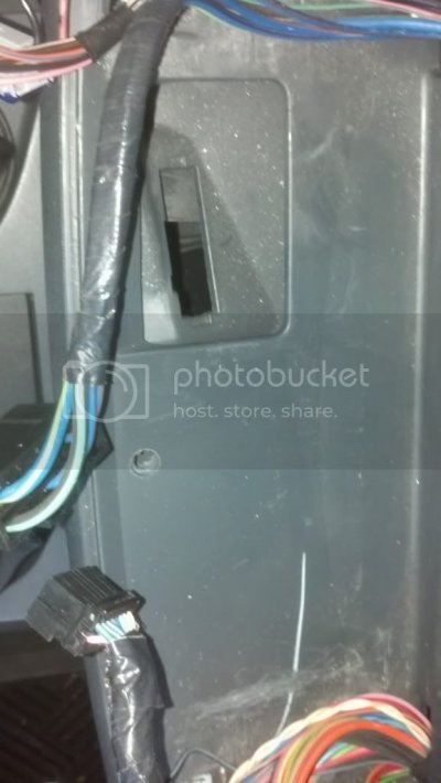

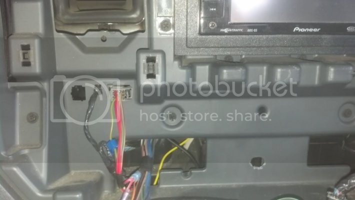

Alright man this was very simple. It took me longer to remove the bezel than it did to mount and wire it up. Here goes, remove radio bezel and you will have a few plugs that are in the spare cutouts. The small black wire harness is what you need its on the far left. Next look inside of the center bezel area and you will see a cutout for the light. Insert the light, plug in the harness and your done. Its not very bright at all in the daytime so i assume it wont be a distraction at night. Heres the pics.

Cool. Also after drivivng last night i noticed its not very bright at all. But it does the job which is seeing the cupholder at night without it being a distraction.

So I pulled the bezel today and of course I don't have the wire harness for the light so I guess ill have to find a scrapped gen 3 and cut it out and transplant it into mine.
redram2007
Sep 29, 2012
1,092
60
Colorado Springs (Ft Carson)
4.7
That sucks did you look in behind that panel bc it may have fallen back in there or not even pulled theough. I will be honest with you it may be easier and better if you did something led aftermarket unless you're set on that light bc its not very bright at all. I just did it bc you brought it up and it was only 10 bucks. There is a DIY on here for that using a couple leds and running them to power and ground. But of course a power source that has 12v when you turn your lights on only.
