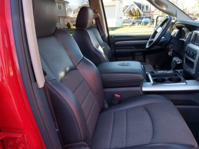

Certain things you can. Seats for example (2012-ish seats in a 2003):

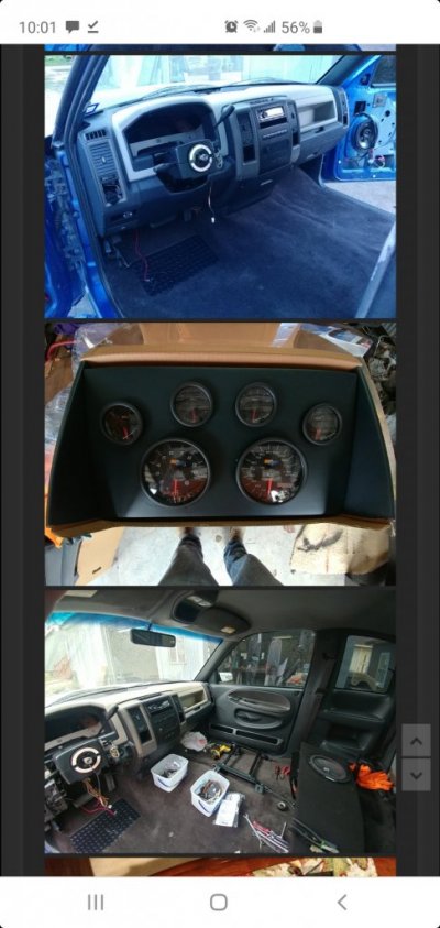

There's a guy on here that's swapped several 4th gen dashes to a 3rd gen, his name is fastmopar69. You use your current wiring harness and need a to trim a little of the 4th gen dash to get it to fit but it's doable. You'll also have to make your own ac piping to the vents. There's even a guy on YouTube that put it in his 2nd gen. You just have to keep the same wiring harness and route it with the new dash. The 06 to 05 will be easier than the 4th gen it should just bolt straight up but again you have to keep your wiring harness and re route it to the new dash.

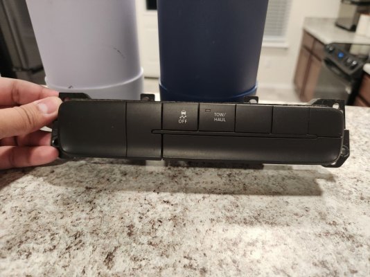

So I am attempting the 4th gen dash in a 3rd gen body, I've found enough pictures and videos of other people getting it done and talked with fast69mopar enough to where I am confident to get this done. But I have these buttons now that will be just for show and I was wondering if I could use them for other things, like a button to make my mirrors fold in for example. There's only 3 pins in the back and im assuming one is power and the other 2 lead to the 2 buttons individually or a ground and then 1 pin to both buttons. If I find which one is the power could I theoretically use these buttons?
Anyone by chance know what the name of this module is called so I can find the pinout in a manual as well

On a Jeep jk forum one of the members took theirs apart and added more switches to control things. Been awhile since I’ve been on the jk platform so I can’t help you much past that. They did have a pretty good write up on it and how to. It looks to be the same exact switch in a Jeep jk.

That switch panel is controlled on the CAN bus, it's not a standard switch so you can't just wire them to other things.

So this particular style on all except like the 2013s? is controlled by a LIN bus on the 4th gens IIRC, so they would be a bit difficult to wire up on their own. One of the guys on this forum made and at one time was selling a kit that came with wiring, fuse/relay box, and everything to make one of these run but I forgot who exactly it was or if they still are selling it.
A little off-topic, but one thing I was playing around with at one point on the 3d printer was adding the Aux switch from the 09-12 Rams and the '12 JKs like from ibikes post into a late 3rd gen. Didn't get fitment down exactly but it was getting there before other things took priority. Didn't know how easy these switches were to modify though, may have to continue down this rabbit hole at some point
