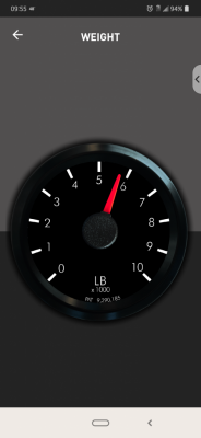

I bought this a few months back and finally had a chance to use it for my trailer. I added weight to simulate the food in the kitchen. That and a basket of clothes in the bedroom is all I added. The trailer is already loaded with everything else.

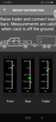

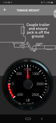

The weight of the truck seems accurate based on what I figured out by hand. (GVWR-payload+me, full tank of gas, payload, step bars, ECT. The overall weight was taken twice. The screen shot I posted was going slightly uphill and the other one was going slightly downhill at the same spot. (Didn't take that one) That one was 14k so I'm calling the total weight 14,250. The trailer was heavier than I thought but the tongue was about what I thought it was. I did have to raise my weight distribution bar brackets up one hole to dial in the hitch. (Equalizer).
Others on various RV forums said that this app was pretty accurate when compared to cat scale weights they had already.

Looks pretty nifty. I don't quite understand the Weight Distribution screen shot. What are the green and yellow bars supposed to be telling you?

The green bars are ideally where my weights need to be. The red bars are where my weight is. It's showing you how much weight is being transfered to the front axle and back to the trailer. It makes more sense if you saw where I started. This pic is my original wd set up. You can see how it changed when I raised the L bracket. In this pic my front axle is light and my rear axle has more weight on it.

Thanks, this is the first time I've towed with this truck. The set up was based on my last truck, a '14 Ram 4X4 so it was very close to start with. That one I set up using measurements.

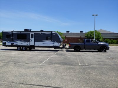

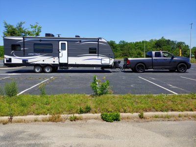

Looks like you're down at the hitch. Did you measure the truck at the front and rear before and after hooking it up? My WD hitch manual says the truck should not settle more than an inch at either end.

This one I didn't measure. With a 1k tongue weight these trucks will always squat. But with that adjustment the trailer tongue came up a bit and more weight was transferred to the front of the truck and back to the trailer. This pic is before I made my adjustment.

Looks like you still are a little bit light in the front, but pretty dang close.

So far, set it and forget it. I do need to find a scale but first I'll need to recalibrate the app because I got a new phone and the info is stored locally on the phone and I'll be installing a set of Tuftruck 1211's. That'll change things up. I just ordered them. I think the tongue weight was a little high as was the overall weight. But I won't know for sure until I get it on some scales. When I get everything weighed up, I'll post an update.
