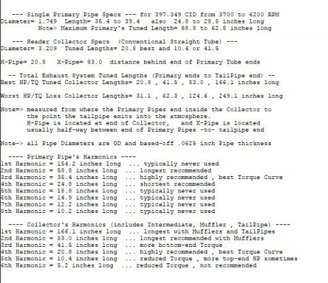

Go big, get the pipemax exhaust design software (45$), get a set of pacesetter (cheap) headers, cut them up/adapt/reweld to get the primary and collector length/diameter correct as per pipemax suggestions. Pipemax will also tell you where to put your x or h pipe and your mufflers. That way you will not only have a awesome looking/sounding but also a top performing exhaust.
Got a set of headers on the way to Belgium and will be doing just this soon, build thread will follow!
Pipemax input data for my stroker setup:
The output
