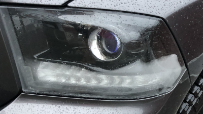

I wish I could’ve been happy with stock. Custom headlights seem to give me the most grief of any mods I’ve done to my vehicles. I have spent a **** ton of money modding my OEM projectors by adding the most expensive HID’s I could find (GTR @ $300usd) These babies have blown 3 ballasts in less than a year.
Then I sent my headlights away to a retrofitter to open them, add switchbacks, smoked markers and paint the shrouds. Since getting them they fog up often in ****** weather, and the switchbacks work most of the time but not always. I have no faith in them and am I into them for well over $1000 plus the value of the headlights. The retrofitter has offered to open and reseal them but it’s across the country and it costs a bunch of $$$ to ship them plus I don’t have spare lights.
we all know what issues come with Morimoto XB’s so that’s not a comforting or cost effective option, and the modifystreets don’t really look any better than stock projectors IMO unless you open them up to blackout the shrouds and tint the signals. Then you’re back into the same headaches i’m dealing with now plus all the bulb out errors and needing alpha And so on.
Basically I am warning people that the more you do to your headlights the more they suck.
I say just throw some LED’s or HID’s in the low beams and forget about the fact that they look like every other one on the road.

Did they drill the dust cover to run the hid's out the back? If so put some silicon around the rubber seal. If that doesn't help. Opening the headlights is easy, especially if they resealed them with butyl. You can toss them in the oven but a heat gun works just as well. It maybe just they didn't heat it up enough to reseal them so heating up around the lense may do the trick. I haven't heard anyone having issues with gtr. Do you have alfaobd? If not I'd look into that. It may solve your issues with the gtr ballast and the switchbacks.

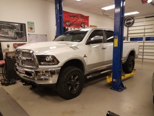

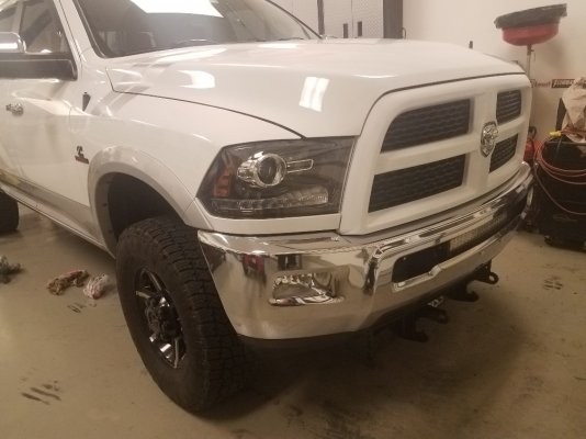

I've experienced the same issues and sadly feel I might have to arrive at the same conclusion. I just purchased some Akkon Headlights recently (still in the box waiting for bulbs to come in) and hope it's the last time I buy a set; but I most certainly feel your pain. If things go south I'll likely end up going back to OEM with upgraded LEDs.

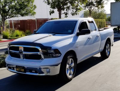

I got $1200 in My TYC projectors and have been having issues with them as well. Just ordered a set of OEM black quads, gonna throw some led's in them and call it a day.
2018 Ram 2500 6.4L Hemi Tradesman
I drilled and installed the HID’s months before they were opened up. There was no fogging untill they were opened. He cut the headlights open and didn’t pry them so im not too sure what was used to seal them.
The switchbacks add a *********** of wires that makes even removing and reinstalling the lights a strenuous task. No alpha which is why I chose the gtr brand in the first place. I don’t see how not having alpha would cause the ballasts to fail anyhoo.
That is 1200 reasons why I bought black quads 2 years ago, installed LED bulbs and done!!
2nd truck, same lights and lamps

The fogging issue is the lights are sealed too tight now, they need to breath. When doing a retrofit, ideally you drill a vent hole in each housing and cover with a gortex patch.
The factory vents are most likely plugged now, dust and moisture plug them easily. Age so does paint vapors if the retrofitted didn't take proper precautions.

@canadiankodiak700 thanks, he sad that too and shipped me 2 types of vents. I drilled one out with a 1/4” hole and the patch which didn’t seem to help. He also sent me a larger screw in type that requires a 1/2” hole in the dust cap but I don’t really want to tackle that to be honest.
He should’ve added them the first time.

Chances are where he sealed things back together there is some pin wholes. The first set I did myself I had condensation issues in one headlight. After resealing it it was fixed. No extra "vent" holes. Next time you have them out snap a pic of where he put them back together. Maybe we can come up with a fix
