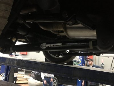

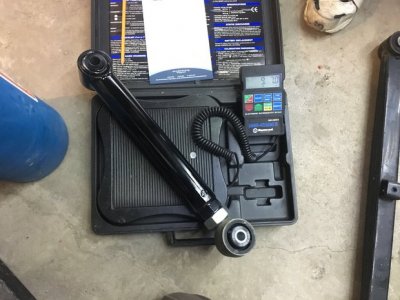

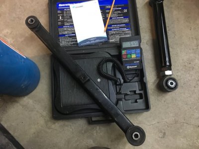

Well we got Robs locating arms on,and I have to say the truck is a lot nicer to drive now. We set the pinion angle at roughly 1.5 degrees down. Between Robs bars and Ryans relocation the brackets it's a night and day difference in how the truck hooks and launches now,it also goes absolutely straight now no more wanting to fishtail on a nitrous launch on street tires,gotta love that,lol. Hopefully a bit later Rob will post up pic's of the arms installed. BTW the weight difference between Robs arms and the stock arms,is just a wee bit,lol. We cut one of the stock bars in half and I was a bit shocked at how light the steel is on the stock arms,and it's not even a DOM quality bar. These are well worth the money.

Rick truck is always a great truck to work on. Always so clean lol. We weighed the old stock arms and the new ones. Mine are heavier. But I would rather heavy then too light.

Gary it was with-in spec at about 1 degree down. I wanted a bit more though to create a little more body separation,so we set the pinion angle at 1.5 with Robs arms
