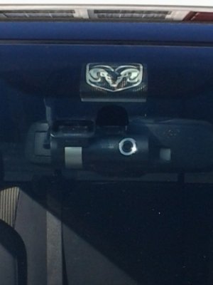

Just took this oic, hopefully its not to dark, it also just finished raining.
I think its wheelwitness, its says its a 4k, i know it has gps sensor to record the speed but that part can be turned off.
I can get a better pic tmrw of the camera48fc8ac1fd8ce3fd4374a823587ba5a3.jpg

arlington, tx
Got a few daytime pics, the power wire just hangs down from the headliner, the install shop did all the running from the console, under the dash and up the pillar. If i want to hide the pwer wite i can just tuck it in.e4476a1bfc8af122ec7c30c866583813.jpgf1c8af4ffb4c9adb076b9dc088a76dfb.jpg0c11b4a106872090453879c98cc3b9c2.jpg
