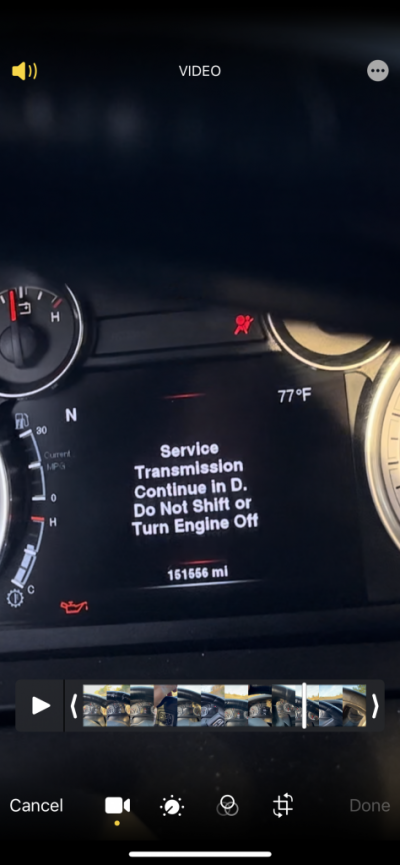

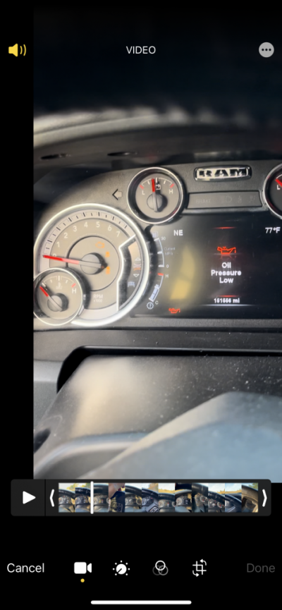

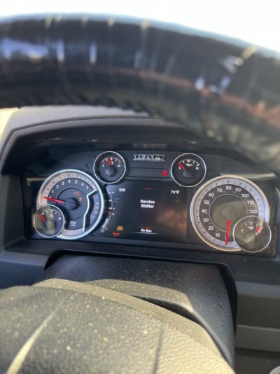

Hi Guys.
I have a strange problem with my truck. the dashboard starts cycling through multiple warnings, controls stop working, transmission stays in one gear, power steering stops, guages stop working, screen will turn off and on and if I stop truck won't go into reverse and windshield wipers will just turn. If I turn off the engine, it will not restart until I unhook the battery for 10 to 15 minutes. the truck is a 2014 outdoorsman with v6 gas engine and 150,000 miles.
The dash cluster will start showing:
1.oil pressure low, traction control out of service,
2. service shifter
2. service 4WD
4. service air bags
5. service electronic throttle control
6. service transmission continue in drive do not shift or turn engine off
For the last couple months, the Serive 4WD light started coming on and off. Then, the above started a few weeks ago. A dealership looked at it yesterday while it was malfunctioning but said they system is not showing any error codes. They had not seen this issue before. They are going to ask around but I thought I would check here as well and see if anyone has had this happen to them. Another garage said it was possessed.
The attached photo is while I was driving.
Thanks for any thoughts.
John

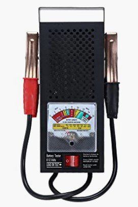

Otherwise, many auto parts stores will load-test your battery for free.
A toaster-style load tester is the best, AFAIC, they never fail to test correctly unlike a digital type of tester.
