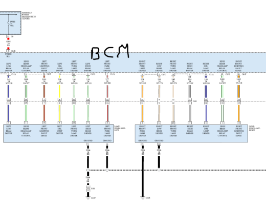

It's all directly controlled by the BCM. If there is a sticking relay, SSR or mosfet, it is non-serviceable and soldered onto a circuit board inside the BCM.
When you flip a switch, push a button, etc, you are just telling the BCM what you want to do.
The BCM then opens/closes the appropriate circuits to make it happen.
This is the diagram for the truck with premium lighting (factory projectors/LED signals). But, if you have quads, the it's just a slightly different version of the same. Fewer wires, but still all directly to the BCM.
