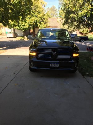

I have a 2014 Ram 1500 Sport and wanted the LEDs to come on as DRLs. I was very frustrated after going to two dealers and being told it couldn't be done or that option was only available for Canadian or Fleet vehicles. One dealer even said there was a different wiring harness for vehicles which have the DRLs which I knew was BS.
Well, here's how you do it: The option code to enable the DRLs is VIN-specific. Someone has to have access to the Chrysler server and through that, they can send the option code for the DRLs down to the specific VIN to enable them. After that is done, access the vehicle through the OBD II port and the option to enable the LEDs as DRLs is available.
They will NOT be on if the vehicle is in Park or if the emergency brake is set.
