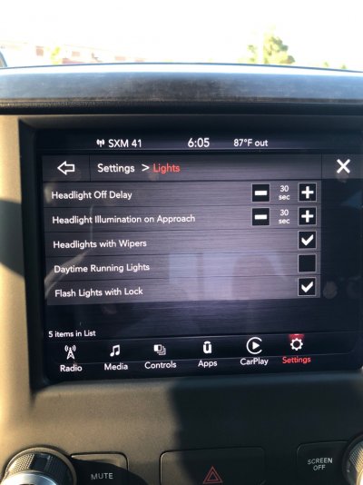

Hello all,
So I have. ‘19 CC BH. I just found out it doesn’t have Daytime Running Lights. 1 I like DRL and 2 i think it would help with my insurance premium. Is there anyway for my dealer to enable them? I’m sure it’s just some code they’ll have to add on or something.
Thanks in advance!

There is an option in the menu to turn them on in mine. My LEDs stay on always and those are enough.

My Tradesman had an option for it also. It was already in the off position when I went into the menu, which I prefer. Check through your radio menus, that's where mine was.

I have the Big Horn package 1 with base 8.4.
Go to settings and scroll down to Lights
In that you will see DRL, and check the box.
