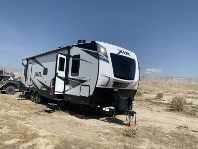

37’ tip to tip. Has huge kitchen/living slide plus master bed slide. Dual ac 150 gal fresh 40 gal fuel blah blah blah. It’s 10,000 dry with nothing in it.

Looks so much longer than mine but it isn’t. I guess hard to tell in pics. Mine is a bit lighter at 8900 empty 132 gal fresh 30 gal black 30 gal grey and single slide. 21 gal fuel.
Looks sweet, I was kind of worried about pulling that much weight with a 6” lift and 37’s but it wasn’t really an issue.

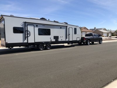

8AD79D6D-B9DA-48CC-AB28-1FE6B737F283.jpeg Well I’m heading out tomorrow. Truck and trailer are loaded heavier than it ever has. 150 gallons of water, 40 gallons of fuel 2 15 gallon propane’s, 2 quads. Enough food, clothes and alcohol for 6 days. If anyone has done the hill north of Bishop, CA on the 395. You know how bad I’m gonna be hurting.
If I can avoid 1st gear I will be impressed.
This is Truck and trailer empty.
