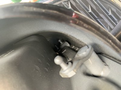

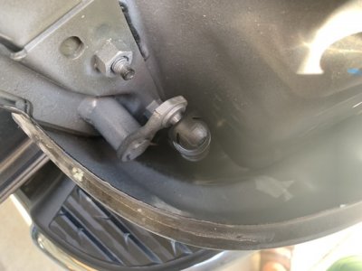

I took the passenger tail light off and found provisions for the tailgate damper assembly.
My only questions is what size munchkin hands do I need to borrow to get down in there...
My huge mits aren't gonna fit in that hole. I may have to enlist the help of my wife to help install this.
Thanks everyone for the help and suggestions!
You don't need to get your hand in there do you? Hold the rod by the upper end, stiff enough to just push the end on the bottom peg, then move the door to align the top ball socket of the rod to pin. Thats what the guy on the video I watched did. Only struggle he had at the start was to get the top on. He was trying to collapse the rod to get the top on until he realized moving the tailgate after bottom was on lined the the top up.

I picked up the damper thus afternoon and got it installed. It’s a five minute job.
I highly recommend this to anyone as it’s a night and day difference!
