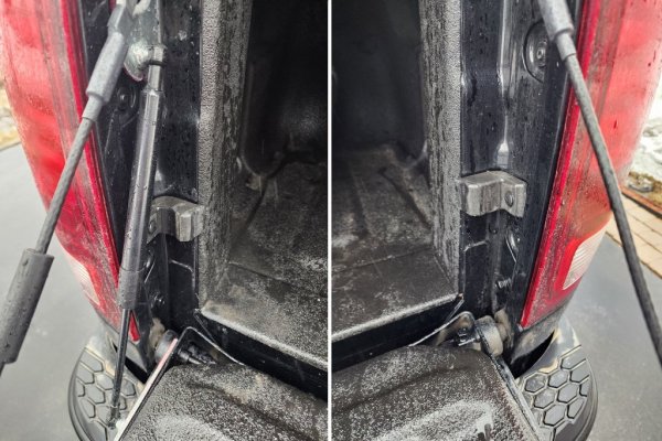

I've installed these on 3 different RAM trucks and have never removed the rubber block. In fact, this must be a new step, I don't remember seeing this step.

Still on mine. Very happy with this add-on.

Same for me, 0 Issues

Just did mine this weekend, I did choose to remove that rubber block. As stated earlier, the cylinder is pushed HARD into the rubber so I decided to remove it. No new squeaks or rattles, gate operates and shuts as it should.

I put one on my Son's 2018 Power Wagon and removed the rubber. I put on my old 2012 3500 and removed the rubber. My Son's 2022 Power Wagon has the factory damper on it and my 2022 3500 has the remote power tailgate with the damper and I believe they have the rubber but are factory. I never had any problem with my 2012 truck and my Son still has his 2018 and it is working great. Perhaps it's what you prefer to do that matters.

I looked at my old directions and it didn't say anything about removing it. Mine still has the rubber bumper and I've had no issues.

On my truck, the upper one stayed on, and I removed the lower one. No rattles after 5 years, no rub/impact marks and DeeZee still works great.
