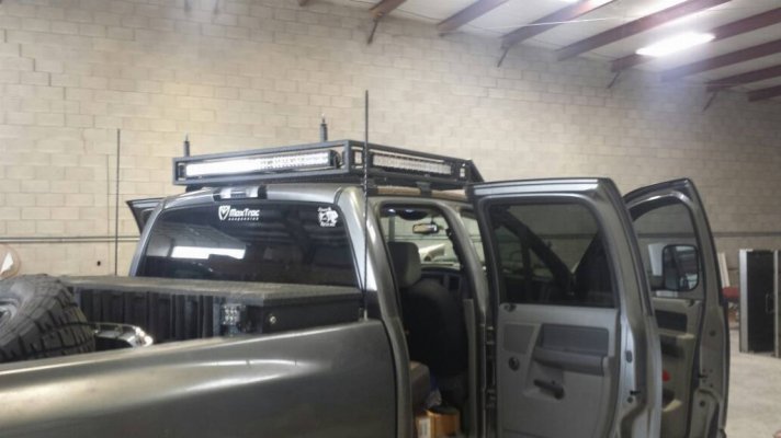

I built it myself man. I'm about to start building and selling them. It mounts between the doors and the cab to the inner frame. e53b169dc3f65d8d32378c393c3b43a3.jpg

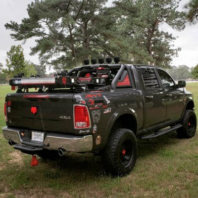

I cut up a thule rack to mount this on my bed. But I like what you did too.e682f6adcdd1ca7415cbc29aa0d42492.jpg509714d92fa6cab4b9fd3ca83388e16b.jpg

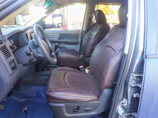

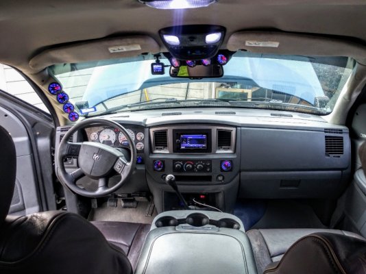

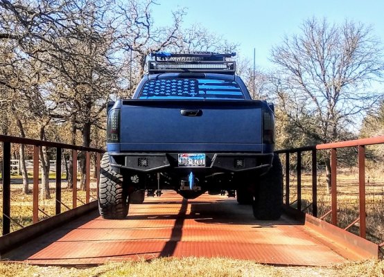

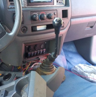

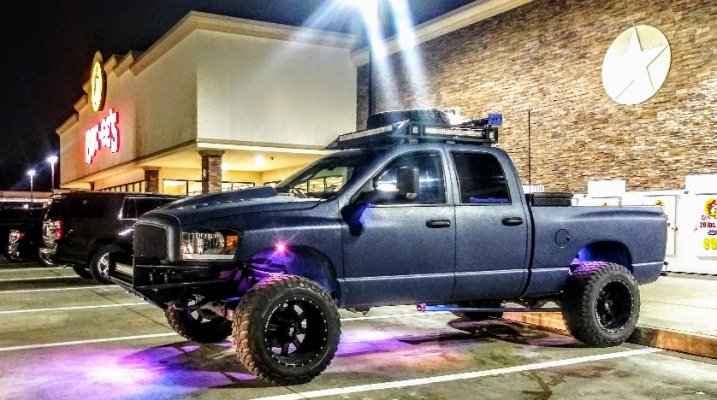

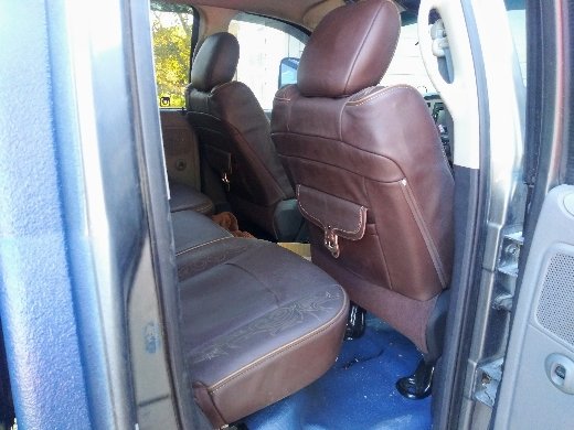

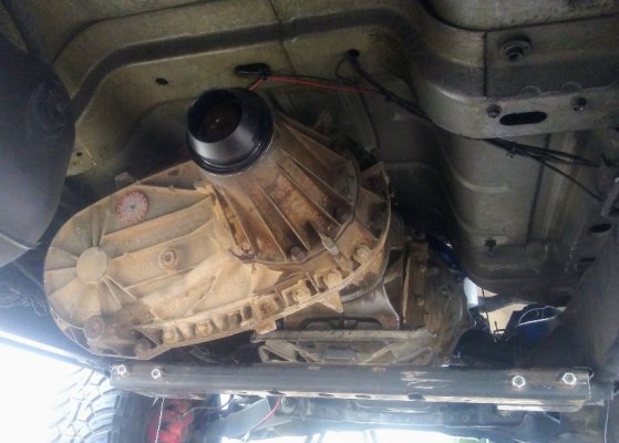

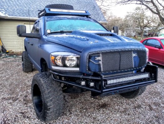

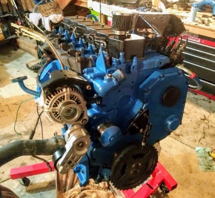

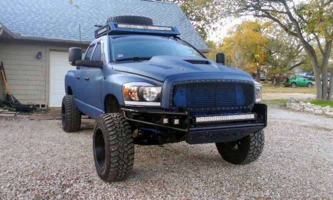

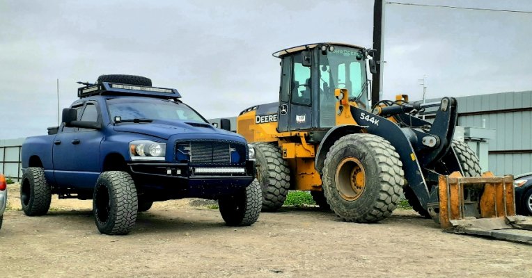

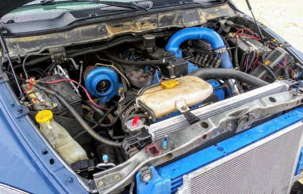

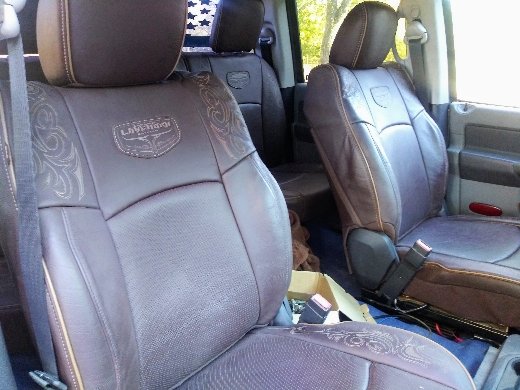

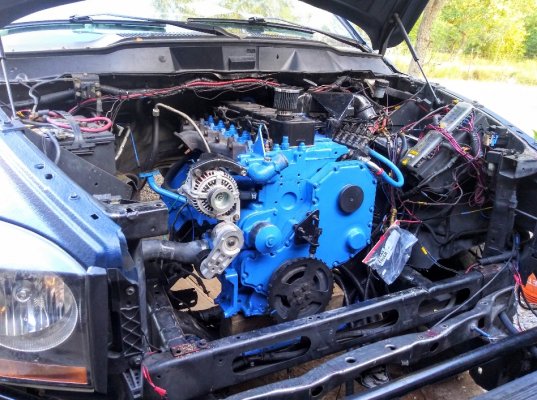

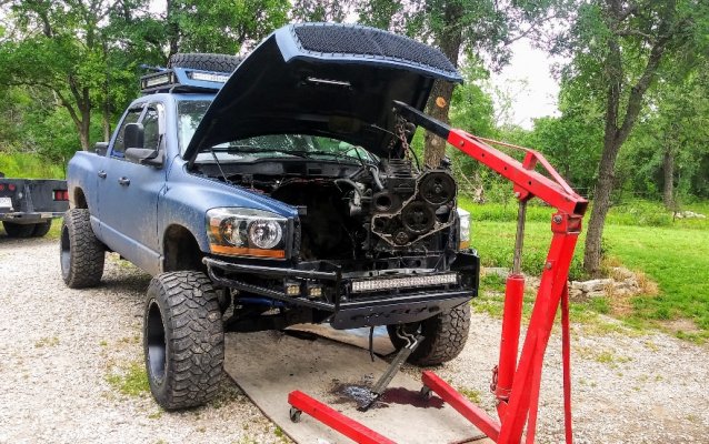

Hey guys. Looks like it's been a long while since I updated this. Lots of changes, I'll try to sum it up. Blew a piston ring about a year ago on the old ve pumped engine and kept having auto trans issues. Yanked both and put in my rebuilt ppump 12 valve as well as a G56 6 spd trans with a dual disk clutch. I also put in the 271D transfer case so I could stay with a 1 piece driveshaft. I still havent solid axle swapped it yet but that's next. While the truck was down I changed the interior up. I replaced the 13 year old carpet with blue vinyl flooring that matched the bedliner. Then I put in laramie longhorn seats and they are damn comfortable. I also hydro boost swapped the truck and added a few more lights here and there while I had time. I found a rear bumper I liked but it came on a 13 F150. I fabbed it to fit and it came out decent. To my knowledge they dont make a bumper like this for a dodge.
Next up is the solid axle swap as well as a bigger turbo and hood stack.[emoji102][emoji102]

That bumper is awesome looking!
