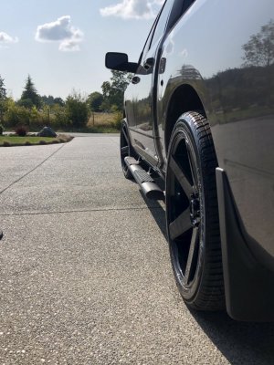

View attachment 248344 View attachment 248345 I’m telling you, I’ve had trucks with 20’s, 22’s and 24’s. The 24’s are nice. Plenty of tire and good grip.
What brands are the wheels and tires?
They're the factory Trackhawks ( aftermarket ) & the tires are 285/40-24 Atturo AZ800's. I'm big on reviews / input from peers , and although I never heard of the brand , they had a lot of very good reviews. They certainly look the part , fwiw.
