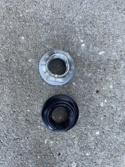

Would someone please explain the difference between these two axle nuts?

I just put the right side CV axle in this morning. I’ve got two different nuts that go over the CV axle. The black one came with the Mevotech TTX wheel bearing/hub.
The silver one that looks like it has a crimp in it came with the new CV axles.
Can anyone explain the practical differences between these two different nuts? In my mind, the one with the crimp is likely to damage the threads. And why would they include something like this with brand new CV axles???
Do I use the one that came with the CV axle (the silver one with the crimp), or the black one that came with the wheel bearing hub?
Thanks for any clarification on this!

The crimp acts as a lock washer to keep the axle nut from working loose. Those crimps are a lot deeper than I'm used to, so unless the nut is soft metal (like aluminum) I'd be afraid it would damage the threads too. On the other hand, I'd be afraid of aluminum causing galvanic corrosion and seizing in place, so I'd use the black nut. Hopefully someone with hands on experience can chime in.

These nuts are single use only. The crimp or swage or whatever someone wants to call it is very important and in my opinion, I want it to be aggressive.
I highly doubt that silver colored nut is going to hurt anything. It should just clearance and kind of self-thread itself as you run it on.
Keep the less aggressive one as a backup.

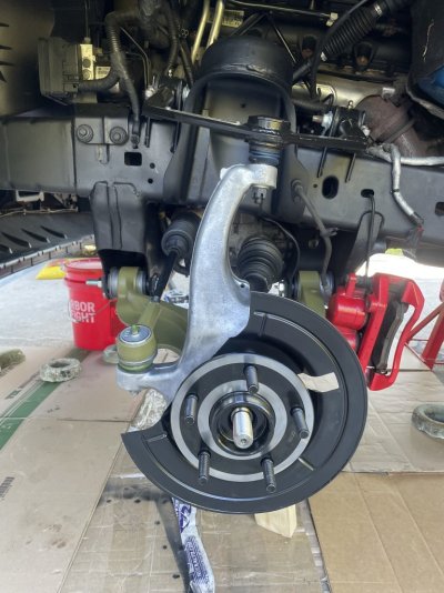

I have all of the other front and components finger tight. So that I could disconnect it and put the struts/springs in. I’ll be assembling the Eibach new struts tomorrow with the spring seats I picked up late today.
I also have a new upper mounts, new dust covers/bumpers.
I bought a good OMP spring compression kit a few years ago (on the advice of a good friend who has a lot of experience working on cars). I actually bought it to work on my Volkswagen Diesel.
It also has an extra curved brace which holds the two sections together around the spring. It’s not in the photo.

If you use the black nut,take a chisel and hammer and put a crimp in it after you've torqued it down.

Both of those nuts have “interference-fit” friction-locks designed into them.
Neither will “damage” the threads. (The friction-lock-design will “upset” and create friction to prevent inadvertent loosening of the nut.)
Use whichever one you like. It will make no difference.

That first pic you posted is crazy. You obviously did a ton of work to get everything looking new and clean.
Nice job!
Please post more pics when you get everything fixed up.
^^^^^THIS!
Cant wait to see the finished product, its really coming along. Its gonna feel like a different truck!

What upper control arm is this that?
Does it have hydraulic power steering?
Is that a DIY frame paint job?

Yes, I removed all the rust. Then sprayed it with rust reformer. Let it sit for several days and then sprayed it with black paint.
The upper control arms are “CORE 4x4”
Power steering I believe is electronically assisted. There is no power steering reservoir.

Reason I asked is I didn't see them in pic and tie rod is on. Don't want dirt/water in that expensive unit.
(Edit): Nevermind, just saw your thread on it. Nice work. I just did similar...all front suspension/tie rods/PPE pan/exhaust manifolds/and same paint job on frame (lol). RWD though, jealous now.
