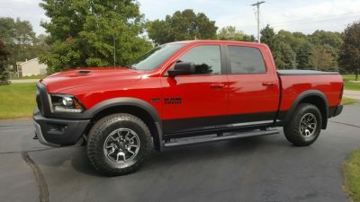

I can cay that I have been driving rams since the 70's and I am tired of driving cookie cutter trucks. So this is why I purchased a Rebel. They come with a lot of off road goodies that normally void the warranty, plus they have a real nice air ride system.
