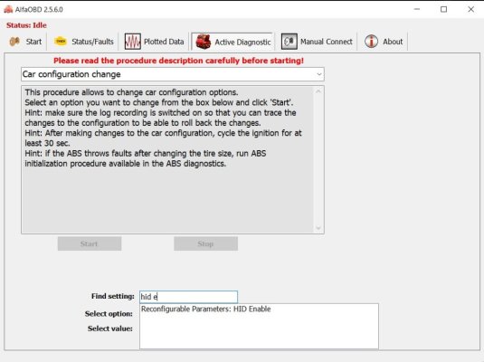

After touring the AlfaOBD BCM options for 2006-2012 Non-PowerNet, the options are signficantly different from my '21.
I can't find any LED options for the Headlights but I do see an HID setting, which should disable the PWM signal.
AlfaOBD/Central Gateway Module (TIPM CWG): My2006-12 Non-PowerNet/Car configuration change/Reconfigurable Parameters: HID Enable

Another option is to select the turn signals as the DRLs, that's how my truck is configured.
Or, you could choose to have the fog lights as DRLs, if you have them.
AlfaOBD/Central Gateway Module (TIPM CWG): My2006-12 Non-PowerNet/Car configuration change/Reconfigurable Parameters: DRL Lamp Location
And this would maintain your legal compliance with having functional DRLs.
