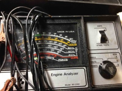

You will need a special tool /analyzer that clicks or buzzes or lights when the sync is set correctly. It reads off the ECM cam sensor.
Other factors that do cause issues with fuel sync are timing chain stretch, or bad cam or crank sensors! Cam sensors rarely fail.
You'll have to find a shop or mobile mechanic that has a fuel sync setting device and have him set it. If you don't have a distributor clamp, any small block Mopar clamp should work.
