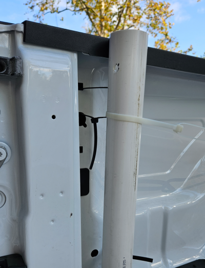

I determined I'd use the location near the tailgate, where there is already a lower mounting point (loop) incorporated into the bed, and would use nearby existing holes in the wall of the truck bed for the upper mounting point. In the two images below, you can see where the black zipties utilize these points. In order to run these through the 2" PVC, I used a 1/2" drill bit and eye balled two holes for the lower mounting point, as well as two holes for the upper mounting point. The lower point and upper point are offset from each other, so just eyeball and mark with a Sharpie where you plan on drilling these holes in the PVC.

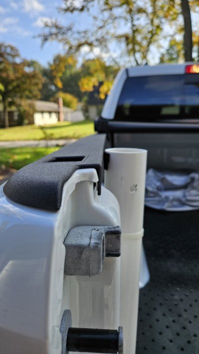

I took the 2" PVC and held it in place, marked a line with a Sharpie. I cut the pipe so that it was JUST shorter than the top of the black truck bed lip, see picture below. This allows me to leave the mount permanently attached, and still be able to close my tonneau cover after I'm done flying a flag. In this picture, also note the black felt tape I decided to use between the top of the 2" PVC pipe and the bed wall, to minimize any chafing over time, as well as possible noise.

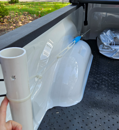

At this point I realized that the tighter I pulled the upper ziptie, the more it was going to pull the top of the flag mount toward the back of the truck. I didn't want this, as simple physics told me this was going to try to happen naturally anyway while driving, since the wind and flag would be pulling everything in that direction. To solve this, I decided to chain multiple zipties (white) together, and utilize the lower mounting loop at the FRONT of the truck bed, in order to provide a constant pull on the top of the flag mount toward the front of the truck, thus "locking" the entire assembly into place much better. See picture below. I also ziptied a microfiber cloth around the ziptie that was making slight contact with the wheel well to avoid scratches as well as any vibration noise. Once I was happy with the setup, I drilled an upper and a lower through-hole in the 2" PVC and tightened everything down. The mount is extremely solid.
