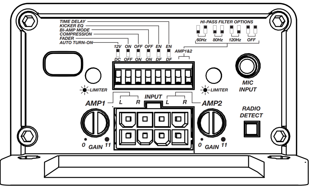

Lastly, does anyone who has installed a Kicker Key amp know if I need load resistors or not? After emailing with NetAudio they recommend load resistors built into their T harness and claim that some of their customers have reported that the internal load setting on the Kicker amp is not enough for the Ram radio. I've also heard from others that they have installed the Key and did not need load resistors. I'm not really sure how to determine if I need them or not.
I use this to power a KICKER 48CWRT84 in the factory Ram Alpine sub enclosure.
I use a Kicker 47KEY5001 to power the Kicker plug and play sub they no longer make for the drivers side SCRAMCQ09.
I use a Key 47KEY2004 to bi-amp the Kicker plug and play Ram speakers (but I swapped the kit tweeters for 51KSC3504
You don't need load resistors for the Key 200.4 It has a built in resistor BUT it must be used to not lose signal from the factory 8.4 radios (labeled radio detect on this diagram).
That helps a ton. Thank you. NetAudio is quoting about 50 dollars extra to add the load resistors to their harness. This seems like quite a lot to me. The only reason I am considering it would be to future proof my system for if in the future I decide to add a more powerful speaker amp and a DSP unit. Since most DSP and more powerful amps don’t have built in DSP like the Kicker does, I assume I would need load resistors at that point. Are they pretty simple to install? I have also seen that AudioControl has some of their load resistors that are plug and play for their amps and DSP units.
I'm not sure on that, but from the Kicker instructions, maybe it's not an issue if you are using low-level inputs?
RADIO DETECT: The RCA inputs on KICKER KEY amplifiers are capable of receiving either Hi or Low level signals from your source unit. If you are using Hi-Level inputs, but your source unit cannot detect an audio system present or refuses to play audio out of one or more speakers, you may need to set Radio Detect to ON. This will activate a load resistor at the amplifier’s inputs and tell the source unit there are speakers present. Do NOT use Radio Detect if you are using a Low-Level input signal; doing so will greatly reduce the input signal.
